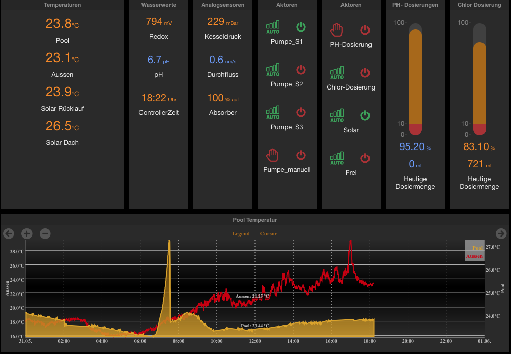

michaelv
Beiträge: 60
Registriert: 6. Januar 2015, 17:03
Re: ControllerModul für FHEM
Beitrag von michaelv »
Hallo
hier meine FTUI Seite für den Pool sieht so aus
Gruss Michael

                <div data-type="label" "class="cell">Solar Dach</div>
                <div class="bottom bottom-space-2x"></div>
</li>
<li data-row="1" data-col="4" data-sizex="1" data-sizey="3">
  <header>Wasserwerte</header>
                <div data-type="label" data-device="Poolcontroller_R" data-part="1" data-fix="0" data-get="Redox" data-limits='[700,780,850]' data-colors='["#669
9FF","darkorange","darkred"]' data-unit=" mV" class="cell big top-space"></div>
                <div data-type="label" "class="cell">Redox</div>
                <div data-type="label" data-device="Poolcontroller_R" data-part="1" data-fix="1" data-get="pH" data-limits='[6.5,7.0,7.8]' data-colors='["#6699FF
","darkorange","darkred"]' data-unit=" pH" class="cell big top-space"></div>
                <div data-type="label" "class="cell">pH</div>
		<div data-type="label" data-device="Poolcontroller_R" data-get="poolControllerTime" data-unit=" Uhr"style="color:darkorange" class="cell big top-space"></div>
                <div data-type="label" "class="cell">ControllerZeit</div>
</li>
<li data-row="1" data-col="6" data-sizex="1" data-sizey="3">
  <header>Aktoren</header>
       		<div class="top-spaces inline">
                <div data-type="symbol" data-device="Poolcontroller_R"
					data-get="Pumpe_S1"
                                        data-states=["0","1","2","3"]
                                        data-on-colors=["green","green","red","blue"]
                                        data-icons='["oa-time_automatic","oa-time_automatic","fa-hand-stop-o","fa-hand-stop-o"]'
                                        class="">
                </div>
                </div>
                <div class="top-space inline">
                                        data-get="Pumpe_S1"
                                        data-on-colors=["red","green","red","green"]
                                        data-icons='["fa-power-off","fa-power-off","fa-power-off","fa-power-off"]'
                                        class="small">
                </div>
                </div>
                <div data-type="label" class="narrow">Pumpe_S1</div>
		<br>
                                        data-get="Pumpe_S2"
                                        class="">
                </div>
                </div>
                                        data-get="Pumpe_S2"
                                        class="small">
                </div>
                </div>
                <div data-type="label" class="narrow">Pumpe_S2</div>
       		<br>
                                        data-get="Pumpe_S3"
                                        class="">
                </div>
		</div>
                                        data-get="Pumpe_S3"
                                        class="small">
                </div>
                </div>
                <div data-type="label" class="narrow">Pumpe_S3</div>
		<br>
                                        data-get="Pumpe_manuell"
                                        class="">
                </div>
                </div>
                                        class="small">
                </div>
                </div>
                <div data-type="label" class="narrow">Pumpe_manuell</div>
</li>
<li data-row="1" data-col="7" data-sizex="1" data-sizey="3">
                                        data-get="PH_Dosierung"
                                        class="">
                </div>
		</div>
                                        class="small">
		</div>
		</div>
                <div data-type="label" class="narrow">PH-Dosierung</div>
		<br>
                                        data-get="Cl_Dosierung"
                                        class="">
                </div>
 		</div>
                                        class="small">
                </div>
                </div>
                <div data-type="label" class="narrow">Chlor-Dosierung</div>
		<br>
                                        data-get="Solar"
                                        class="">
                </div>
		</div>
                                        data-get="Solar"
                                        class="small">
                </div>
                </div>
                <div data-type="label" class="narrow">Solar</div>
	  	<br>
                                        data-get="Frei"
                                        class="">
		</div>
                </div>
                                        data-get="Frei"
                                        class="small">
               	</div>
                </div>
                <div data-type="label" class="narrow">Frei</div>
</li>
<li data-row="1" data-col="5" data-sizex="1" data-sizey="3">
  <header>Analogsensoren</header>
                <div data-type="label" data-device="Poolcontroller_R" data-part="1" data-fix="0" data-get="Kesseldruck" data-limits='[-100,200,1200]' data-colors='["#6699FF","darkorange","darkred"]' data-unit=" mBar" class
                <div data-type="label" "class="cell">Kesseldruck</div>
                <div data-type="label" data-device="Poolcontroller_R" data-part="1" data-fix="1" data-get="Durchfluss" data-limits='[0,2,10]' data-colors='["#6699FF","darkorange","darkred"]' data-unit=" cm/s" class="cell b
                <div data-type="label" "class="cell">Durchfluss</div>
		<div data-type="label" data-device="Poolcontroller_R" data-part="1" data-fix="0" data-get="Absorber" data-limits='[-2,100,105]' data-colors='["#6699FF","darkorange","darkred"]' data-unit=" % auf" class="cel
		<div data-type="label" "class="cell">Absorber</div>
</li>
<li data-row="1" data-col="8" data-sizex="1" data-sizey="3">
  <header>PH- Dosierungen</header>
		<div data-type="range" data-device="Poolcontroller_R" data-low="" data-high="pH-_Rest" data-width="25" data-max="100" data-min="0" data-limit-low="10" data-limit-high="100" data-color-low="red" data-color="
orange" data-color-high="green" ></div>
                <div data-type="label" data-device="Poolcontroller_R" data-part="1" data-fix="2" data-get="pH-_Rest" data-limits='[10,30,90]' data-colors='["darkred","darkorange","#6699FF"]' data-unit=" %" class="cell big
top-space"></div>
                <div class="bottom bottom-space-1x"></div>
                <div data-type="label" data-device="Poolcontroller_R" data-part="1" data-fix="0" data-get="pH-_consumption" data-limits='[0,200,800]' data-colors='["#6699FF","darkorange","darkred"]' data-unit=" ml" class="
                <div data-type="label" "class="cell">Heutige Dosiermenge</div>
</li>
<li data-row="1" data-col="9" data-sizex="1" data-sizey="3">
  <header>Chlor Dosierung</header>
                <div data-type="range" data-device="Poolcontroller_R" data-low="" data-high="Cl_Rest" data-width="25" data-max="100" data-min="0" data-limit-low="10" data-limit-high="100" data-color-low="red" data-color="o
                <div data-type="label" data-device="Poolcontroller_R" data-part="1" data-fix="2" data-get="Cl_Rest" data-limits='[10,30,90]' data-colors='["darkred","darkorange","#6699FF"]' data-unit=" %" class="cell big t
op-space"></div>
		<div data-type="label" data-device="Poolcontroller_R" data-part="1" data-fix="0" data-get="Cl_consumption" data-limits='[0,300,3000]' data-colors='["#6699FF","darkorange","darkred"]' data-unit=" ml" class="
</li>
<li data-row="6" data-col="2" data-sizex="8" data-sizey="2">
   <header>Pool Temperatur</header>
       <table width="100%" height="85%" border="0">
                <tr><th>
<div class="fullsize"
                data-type="chart"
                data-logdevice='["FileLog_Poolcontroller"]'
                data-logfile='["Poolcontroller_neu-2017.log"]'
                data-columnspec='["4:Poolcontroller_R.Pool","4:Poolcontroller_R.Aussen"]'
                data-style='["ftui l0fill","ftui l2"]'
                data-ptype='["lines","lines"]'
                data-uaxis='["secondary","primary"]'
                data-legend='["Pool","Aussen"]'
                data-yunit="°C"
                data-ytext="Aussen"
                data-minvalue="auto"
                data-maxvalue="auto"
		data-minvalue_sec="auto"
		data-maxvalue_sec="auto"
		data-yunit_sec="°C"
		data-ytext_sec="Pool"
                data-yticks="auto"
                data-daysago_start="0"
                data-daysago_end="-1"
                data-crosshair="true"
                data-cursorgroup="1"
                data-scrollgroup="1"
                data-showlegend="true"
                data-width="100%"
                data-height="100%"
                data-xticks="auto">
        </div>
</th>
</tr>
</table>
</li>
</ul>
</div>
</body>
</html>
Bildschirmfoto 2017-05-31 um 18.23.38.png (133.73 KiB) 148 mal betrachtet
Syon
Beiträge: 119
Beitrag von Syon »
Vielen Dank, das hilft.
